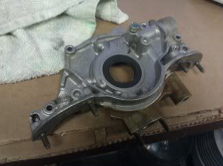

Here's some pics of my first attempt at porting an oil pump. I was actually pretty proud of my end results, this being my first time. Let me know what you think!

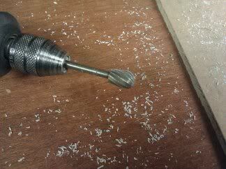

I found this single cut, fairly mild burr to be the best choice. It removed a nice amount of material without digging a fat hole in the casting.

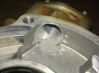

Before-

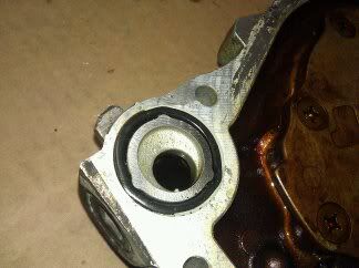

After-

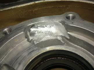

^^^JB welded and smoothed for a nice consistent flow pattern.

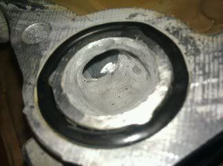

Got a little happy with the dremel on this one ^^^ , had to fill with a little JB weld.
Here's after I brakleen'd the shit out of it. Nice and clean!

The porosity in the used pump means it's actually still coated with oil no matter how much you cleaned and prepped. I would not trust jb weld to hold on given the application.
-Luke
#4 ·
Thanks for the input. I recall reading somewhere that JB Weld would be ideal for this application, as well as Devcon. I don't believe the couple pores in the JB weld is from oil, I put it in a parts cleaner for a few hours and brakleen'd it dry. I would blame my patchy application, to be honest. I guess I can only hope at this point lol.
#6 ·
I'm not talking about the bumps in the JB weld. Cast aluminum is porous. (Well, most cast aluminum is.) A used pump is saturated with oil. Oil prevents ANY epoxy from bonding well. JB weld is extraordinarily poor in this application. Devcon is better than JB weld. JB weld is used in a lot of situations by a lot of people with more creativity than sense.
That is NOT going to hold up. I don't think that it would hold up using devcon on a used pump. There are epoxies I know of that are formulated to work (Belzona stuff comes to mind), but it would likely shock you with how expensive they are.

There is jb weld in the pics, where I ported from the pump outlet to block inlet and theres a small amount where i ported the outlet for the pickup.
Here, to give you a better idea...
That was the block inlet after porting but before JB welding. You can see how the oil would go back, swirl, and then flow out the pump. I reshaped that flow to be one smooth motion.
